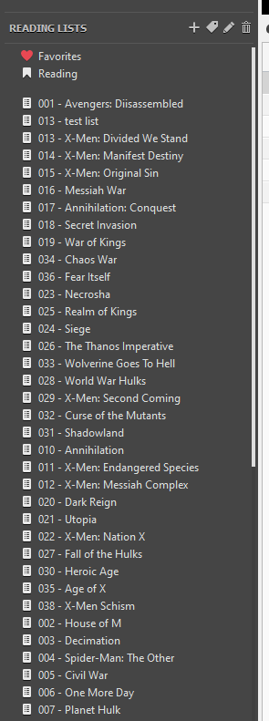

When I create a new list (using the + button) it seems to add it at random. I even tried a new list (013 - test list) and is added it after the first list. However, last night, I was able to create lists numbered 045 through 054 and each automatically added themselves at the very end of the readling list listing.
Also, I am unable to drag or drop top level lists. I try to drag holding the title, as well as the icon. They seem to be locked in place.

You can’t rearrange top level lists, they should be sorted alphabetically, I don’t understand why yours aren’t.
If you need a relation between lists then create a top level list and add sublists.

I think I know the issue now. When renaming top level lists, it maintains it's order / rank in the list based on the original naming convention.
