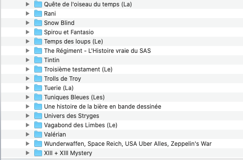

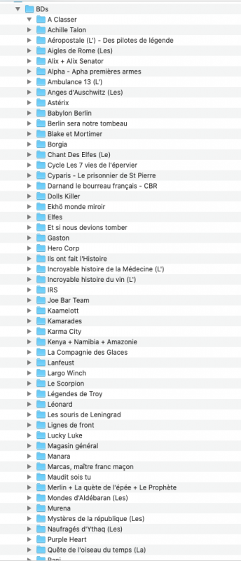

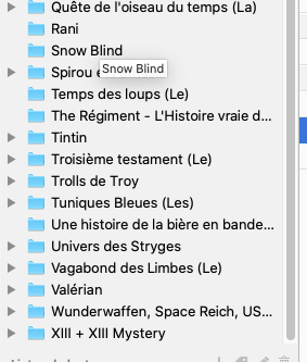

Hello
I have an issue with TYAC Library version 9.6.2.1909283 on my MBP running Catalona 10.15.4
I added some comics to YAC, asked to reindex the Library and the new folders never appear ine the list.
I've tried to delete the libreay and recreate it but no change.
You can see the differences in the attached files.
Is it a known issue ?
What can I d to fix it ?
Many thanks by advance,
Have a nice day,
CHC

6 years 6 months ago #5222
Replied by Luis Ángel on topic YAC Library not showing all trhe folders
what is in the folder that did not appear in the library? folders are only added when valid comics are found inside.
6 years 6 months ago #5223
copy one of the folders that do not appear to a folder in your desktop and create a library there, is the folder properly imported? or do you end with an empty library. If you can replicate the problem doing that, then send me one of the comics in the folder.
