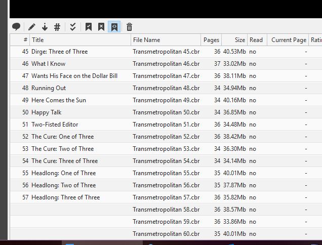

I have imported my comics, but I am finding any comic series (folder) that has more that a certain number of comics, the last 3 do not sync. This is happening on multiple occasions.
I don't know exactly what the threshold is (I am guessing 50 or 60 comics in a folder), but for folders that have more than, say, 60 comics the last 3 files do not sync. See attached.

Okay.
I had closed yacreader library last night. After getting home and launching it, the missing comics are now there.
I've attached a screen shot showing how last night only the first 57 comics were there to be tagged by comic vine. Comic vine was showing there were 60 in the series - this is actually how I realized the last 3
files were missing
So I don't know what happened, but seem to be all good now.
files were missing
