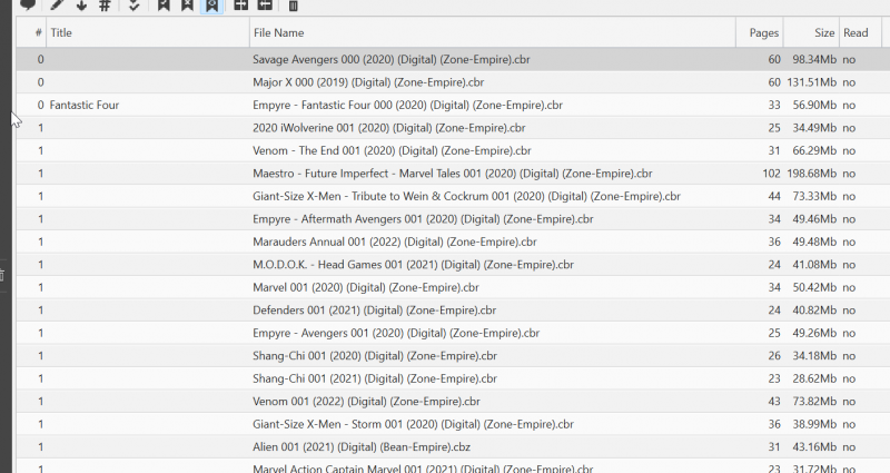

the library no longer seems to sort by file name - I am clearly not doing things correctly any help would be greatly appreciated
4 years 1 month ago #7164
Replied by Luis Ángel on topic how do I configure the library to sort by filename
It sorts by file name (both files and folders) by default, but it will sort by issue number if a comic has assigned an issue number. Is this the case? If so, edit the comic and delete the number.

Yes it appears to have added numbers and titles
when I delete the library and re-create it - they return - how do I bulk edit the metadata?

It seems that those files include a xml metadata file and YACReaderLibrary is getting the metadata from there. Can you double check that the xml file is inside?
4 years 4 weeks ago #7180
Check this dev build. I have added a feature to remove all the metadata in the selected comics.

Replied by webbie on topic how do I configure the library to sort by filename
thanks - I did use the non qt6 installer - i uninstalled first than ran the installer again - worked this time
the delete all metadata - worked - thanks a bunch
