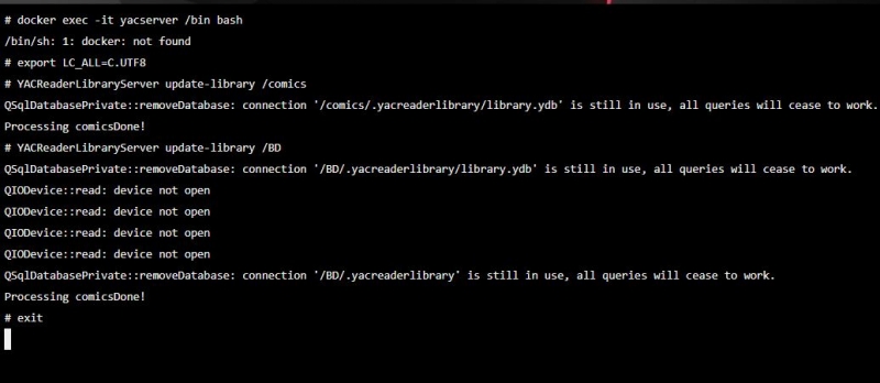

Ok, I made a mistake here. I don't think that this worked for you after all.
First of all, the first line should look like this:
I forgot the slash between /bin and bash. But /bin/sh should work too.
But if this worked you shouldn't see the QIODevice messages and you also should get a number of comics processed after the update, like this:
So something is clearly wrong. Could you double-check if the special character files have been added?
$ docker exec -it yacserver /bin/bash
Processing comics.........................................................................................................................................................................................................................................................................Done!
Number of comics processed = 265

The docker command line doesn't work, I always get an error message (see also the 2nd line of the screenshot in my previous message)
export LC_ALL=C.UTF8 went fine !
After hving run it and updated my BD library, I can now see the previously missing comics, but clearly, I don't get the number of processed comics shown.
I just don't know if all have been found, but most of the one I've checked are now visible.

8 years 4 months ago #4123
Replied by selmf on topic Server will not import comics w special chacters
For anyone reading this: The fix is now included in the latest container from muallin. Manually setting the locale shouldn't be necessary anymore.

Thanks again for your help. I do confirm all work fine with the latest version of the container.
