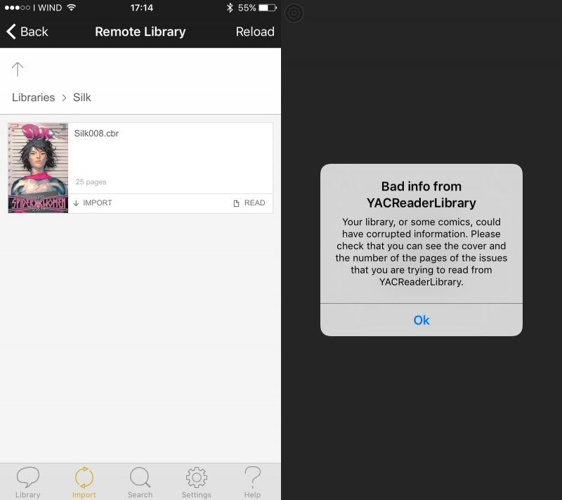

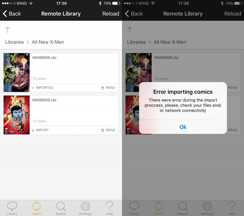

Here the last lines of the log file:
And here are the screenshots from the iPhone app:

I tried to add other comics and there is the same problem, the strange thing is that the iPhone app can detect the comics that I already imported (using YACReaderLibrary on my Mac) displaying "IMPORTED":
As I'm on Raspbian I couldn't install unarr, so I downloaded and extracted github.com/zeniko/unarr/archive/master.zip in yacreader/compressed_archive/unarr/
EDIT:
- Andrea
Last edit: 10 years 6 months ago by AnMartini. Reason: Update

I also tried to add another comic to the library using update-library on YACReaderLibraryServer and received this message:
After this update the newly added comic gives the error, while the other comics continue to work.
EDIT:
Also, I don't know if this can help, but opening the library via browser I noticed that clicking on "READ" for comics added on YACReaderLibrary on the Mac cause the download of a metadata file (remote), but doing the same thing on comics added on YACReaderLibraryServer just show a page with a 404 error.
