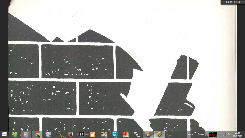

11 years 9 months ago - 11 years 9 months ago #1054 by Qulox
Replied by Qulox on topic YACReader beta 8.0
I had not noticed that hardware acceleration was disabled, probably because I always had it activated since it was supported in the library so I sort of assumed it was enabled by default.
Now that I activated it works as supposed to, but it hangs every time if I try to change view mode with HW acceleration disabled.
Thank you for the support.
EDIT: btw I just discovered that you can't minimize to desktop while in fullscreen on YACReader.exe in Win8.1 by pressing WinKey + D. The taskbar shows but you can't select nothing. (I almost died while discovering it :s )

11 years 9 months ago - 11 years 9 months ago #1055 by Luis Ángel
Replied by Luis Ángel on topic YACReader beta 8.0
@selfm: the grid view needs QtQuick and QtQuick2 modules, do you have these modules installed in your system?
@Qulox: I think that the the issue is also causing that YACReaderLibrary doesn't really ends after closing the application. My guess is that there is a thread that keeps working and preventing the SW flow to be closed. EDIT: My guess was correct, I already fixed this issue.
I am not wrong, the Win+D thing is related to the patch for the fullscreen bug that is used in Windows. This is going to cause me some headaches.
Thank you for your help guys!
