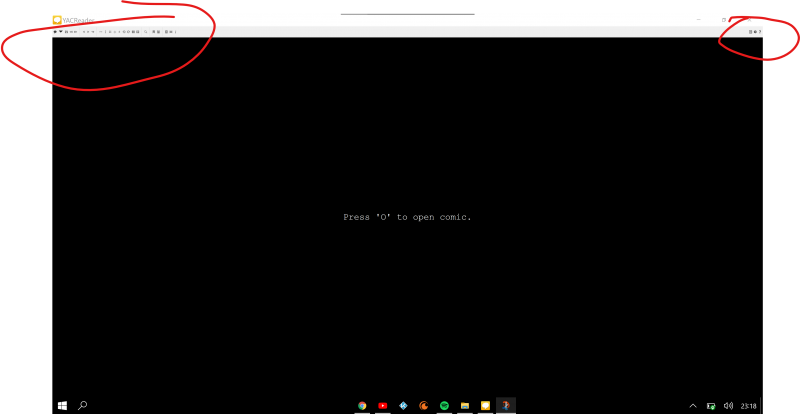

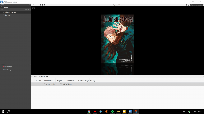

Hi all
if you check the attached images, the interface for me some reason its ridiculously small. I have no idea why its become like this on my device,
I am using a windows 10 laptop, and have not dealt with this issue wtih any other application
I have seen youtube videos of people using this application and their inferface icons are much larger. I can barely see mine and interact with them thus making this app impossible to use.
Please if you have any help it would be much apreciated. thank you

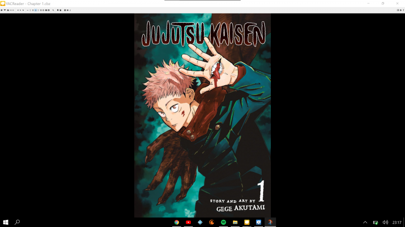

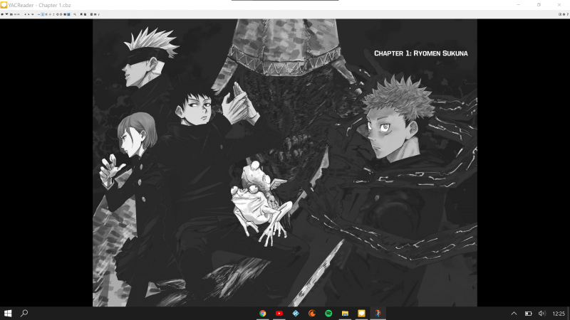

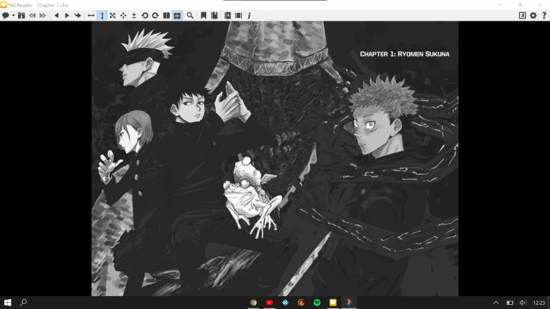

That seems to have fixed that issue! however, although the interface scale is normal sized now, the comics are quite blurry/pixelated, if you check the attached photos, when I overrided the DPI setting, its made the comics blurry
So basically, I either will have
HD comics but with miniscule interface, or
somewhat pixelated comics with standard-scale interface
