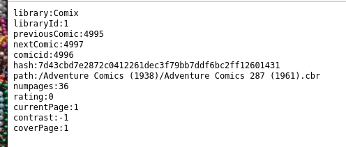

5 years 10 months ago #5678 by jefftr66
Replied by jefftr66 on topic YacReaderLibraryServer dockerized
So I was able to create the YAC library docker container - works great. I can access the comics if I'm at home via the assigned local IP & port.
I was also able to create a reverse proxy website so I can access the library at yac.xxx.xx. However when I click on the read button I only get text - a description of the file itself.
Any ideas?
Jeff
5 years 10 months ago #5680 by Ruescas
Replied by Ruescas on topic YacReaderLibraryServer dockerized
jefftr66 wrote: So I was able to create the YAC library docker container - works great. I can access the comics if I'm at home via the assigned local IP & port.
Any ideas?
Jeff
Same problem here.
